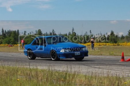

A fellow autoxer took pics of the last event.
Look at how much roll there is w/ the Mustang. Damn. . . no wonder it's such a slug.
Notchbmp1
This is with 450 front and 350 rear coilovers, Hypercoil brand (and no sway bars). I think it's time for stiffer springs.
I think I'll go with Eibach brand coilovers. That's what I'm using on the SHO.
Or some bars if you want to drive it on the street. Controlling roll strictly with the springs usually means that the springs will be so stiff that driving it on the street will be very risky. Any little pothole may essentially remove a corner from the car.
Anti-roll bars aren't a bad thing to use to get the best compromises, and it looks like some reasonable bars might help that car a lot without having to get too crazy with the springs.

I agree - A front swaybar is almost always good for a RWD autocross setup.
The Mustang isn't McPherson up front, is it? Been a while since I poked my head under the front of one.
450/350 is pretty soft overall, especially once you calculate the wheel rate. I'm running 625F/500R on my car, and the street ride is acceptable. I also run a 28mm swaybar up front, and the stock rear bar... But IRS is a little different to tune (obviously). I would imagine you want to stay away from a rear swaybar with your car, as all it will do is unload the inside rear tire. A front bar will make the car much more responsive through transitions, and in all likelihood improve front grip in all conditions by keeping the suspension in a better part of its camber curve.
If you're not planning on doing much street driving, and plan to continue to run R-comps (or stickier) for track/autocross, I would bump the spring rates up by a good bit. Softer in the back is great for a RWD car as long as you can get the front to bite (should be easy with no rear camber). You might get a set of 550-600 for the front, and move the 450's to the rear as a starting point.

Appreciate the comments.
The Stang is not street driven so I am not worried too much about ride quality. I just want it to handle.
The front isn't McPherson. It's Primitive. In the stock configuration there is a big fat coil spring that sits inboard of the shock absorber. When you switch to coilovers, that fat coil spring is removed.
I would prefer to tune with springs. I'm hesitant to use swaybars - the front SB is a big chunk of metal that weighs about 40-45 lbs. and the rear is not light either. If I could find a smaller front SB I might do it. Some aftermarket vendor out there probably makes one.
Also with the current configuration, this car understeers worse than the SHO, believe it or not (it's also nose-heavy) . . . another reason to avoid a front SB.
I may go with 600/500 . . . they say for the Stang the rear should be about 100 lb/in less than the front. Koni's for the stang have much stronger dampening than those for the SHO, so they should be able to handle the stiffer rates.
Now that I look closer at the picture, it seems like the front is rolling more than the rear. (Cover the front half of the car with your hand, then cover the rear half and compare.) D@mn, that's some serious unibody flex, LOL! It definitely needs a cage.

In some cases, the front swaybar will actually add front grip by keeping the suspension in a better part of its camber curve - That's how most McPherson strut cars end up. They also end up with 3 wheels on the ground some of the time, but it seems to work. :)
40-45 lbs of swaybar is a lot. I thought my 28mm bar was bad, and it's maybe 20 lbs. I agree, most of the tuning should be done with springs, but in order to get the car working really well you'll have to go way stiff (and probably have the konis revalved) if you want to get the roll under control. That - and eliminate some of the chassis flex, as you've noted!

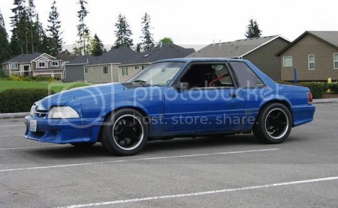

An update. . .
Since my last post the Mustang has undergone some changes:
- addition of 6 point roll bar (more to stiffen the unibody than anything)
- 650/550 f/r coilovers (from 450/350)
- H/C/I swaps to bring it to approx. 310 rwhp / 350 rwtq
- Tubular K-member to improve front end geometry (allowing more caster and a better camber curve)
- The rear remains straight axle with Torque Arm and Panhard bar.
- Weight right now is ~2,750 lbs. without driver
- aftermarket front roll bar that is lighter, less stiff than stock unit
- retained stock rear sway bar
The car now cornered much more flat and had tons more power, at least with casual driving at legal speeds. The unibody felt pretty solid and responsive, unlike before.
I was feeling pretty good about it.
Took it out for autocross July 7 and lo and behold, finished 69th out of a field of 107. At race-level driving, the Mustang was uncontrollable. No rear traction at all. Snap oversteer at anything past 1/2 throttle. It was embarassing. It looked like a drift car on an autocross course. And this was on Hoosier R compounds. Couldn't even keep up with the Hondas on street tires.
I was ready to throw this hunk of metal off a cliff.
Well, back to the drawing board. . .
The big problem is this - you can't get any action without traction.
So how could I maximize rear tire traction on this beast?
Go back to the basics-
- wider rear tires
- soften the rear end
- widen the rear track
So, I went to 295's on 10" wide rims (previously 275's on 9").
Kept the 275's in front.
Removed the rear swaybar.
Installed rear axles that are 3/4" wider per side.
Now with the staggered setup it looks like a freakin' drag car. ;)
Took it to autocross July 20th.
The Mustang was freakin' SOLID. The rear actually STUCK to the ground. It handled the course like a freakin' hummingbird on crack cocaine. I was going through slaloms and sweepers at FULL THROTTLE.
I couldn't believe it! I was completely shocked!
I was so dumbfounded by this I kept missing the same gate my first 3 runs (of 4). Kept going outside the cone instead of inside.
My 4th and final run was actually clean, but I blew the 2nd-->3rd gear shift - fumbled the shifter for about 2-3 seconds until it finally clicked into 3rd, but still managed to get a 51.6 which was 9th fastest (of 152) overall raw time of the day.
Results posted here.
That blown shift probably cost me over 1 sec. The stock shifter on the T-5 is a WORTHLESS PIECE OF **** - it is going to get upgraded right away.
We had fun runs afterward, and I consistently ran in the 49's (49.2 to 49.8). If I had done that during my official runs it would have put me at 2nd to 3rd fastest overall raw time of the day, right there with the ASP Viper!
Next meet coming this weekend and I absolutely cannot wait. The 295's are going in front, and the rear will get 315's.. . . the paint job can wait a little longer. . . :rofl:
