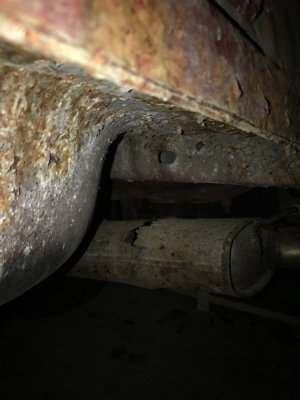

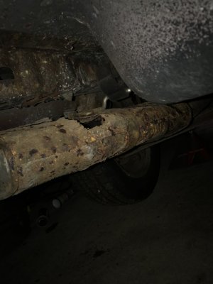

So today I finally got my 94 in the garage and up on jack-stands for an inspection and to begin working on mechanical restoration. The first thing I noticed is the exhaust is GONE on this SHO. I’ve included some pics for lols but my question is:
What to buy?
I am aiming to put a tune on her as well as some performance mods, but don’t know what is recommended for the ATX’s. I found the SHO source Y pipe, but is that the best option?

The Shosource Y-pipe or Magnaflow y-pipe is for an manual transmission car. Is your Y-pipe that bad? The ATX Y-pipe isn't as restrictive as on the MTX car. An aftermarket exhaust will be a used one if you can find someone selling it.
If you just want to get it back on the road, I would consider finding an exhaust from another ATX SHO that lived in a rust free state or was not driven much in winter.

Pretty sure it starred it out because the forum though you swore *gasp*. The rest of the car is surprisingly rust free, I have one spot in the engine bay and one spot on the rear passenger door jamb that needs some sheet metal, but all the paint is good. Surprisingly, everything on the underbody is clean for a Michigan car (aka the rockers are all there). Just needs a wire brushing and some underbody coat and it’ll look good as new. As for the Y piping that Zoomlater asked about, it looks to be in good condition but if I’m digging into the exhaust I may as well upgrade what I can. And if I end up leaving the Y pipe, what mufflers and down pipes from there sound the best?
