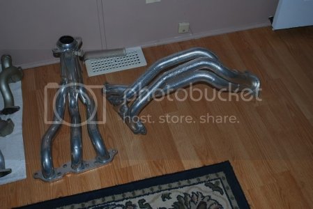

Thanks , and whats in there is a cammed , ported , 3'' exhaust , 3.2 mtx , and 1.75'' headers home made. Not equal length , just making them is something - for the minimal gains you might get (if any) Im not sure if its really worth the effort. But , its your money , not mine.

Those headers look nice and curvy....how I likes it :p Unfortunately they won't fit my longitudinal ranger. I know the name's SHOTANG, but I came to my senses somewhere along the way and realized that my vulcan ranger already has a lot of the parts needed for rwd SHO fun. From what I gather, firewall issues for the ranger swap are due in large part to the coil packs and heater box on the other side. I'll hopefully mitigate those issues with a COP sequential Megasquirt, a 97(?) heater box from a 4.0, electric Davies-Craig pump and controller...... Oh, and 12.5:1's + port propane, muha!
