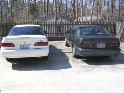

should have no problems. when I fitted the 89 GL/SC with the dynomax, the rear exhaust pipes fed out straight under the bumper edge. as I recall, they were a little tight, and may tend to rub or be very close to the bumper on the gen 1 rear bumper. however, a little creative twisting and adjustment of the rear mufflers should do the trick.
will post a pic of the 89 w/ dynomax if I can find it ...
OK here is a shot of the 95 ATX, and 89 GL/SC, both w/ Dynomax. Fits fine.
Two SHO March2005 small

Yup. It will fit, reguardless of what the Dynomax listing says.
