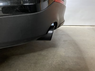

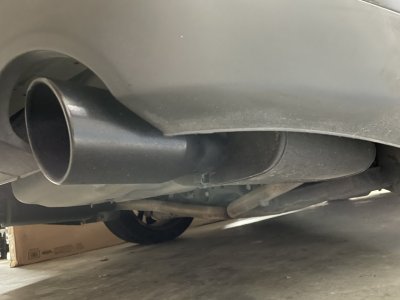

No worries, I appreciate it. Everything looks good alignment-wise. Did it go together pretty easy, or did you have to mess with it a bunch to get it to line up? Also, did you utilize the rear-most hanger?
I had a muffler shop put them in. I bought the mufflers, painted them, bought the tips, and took everything down to the shop. They welded in the mufflers and put on the tips using the clamps the tips had built in. I just told them kinda how far I wanted the tips to stick out and they lined it all up. And yes they used the rear-most hangers, they welded hangers onto the mufflers that lined up with the one on the car.
