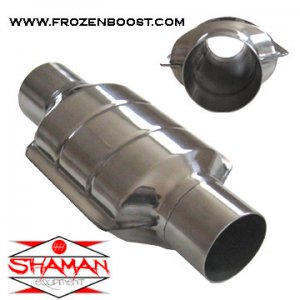

I like my car catless it has been 7-8 years like that. Although I have a pair of cats on my bench to be installed when I get the car out. These are what you call true High flow units.
Cat allflow picture
