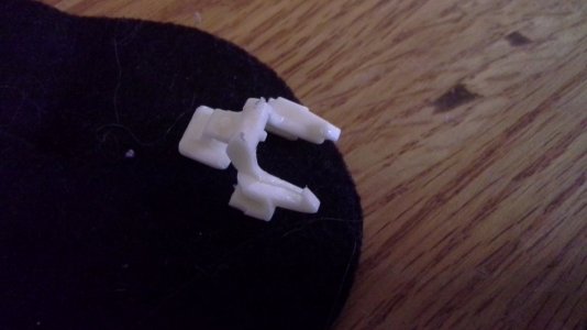

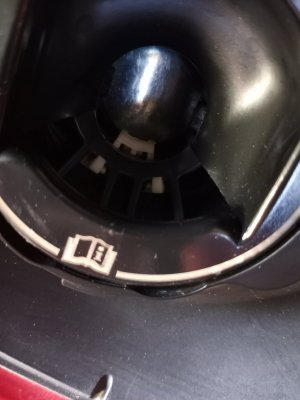

So I replaced the filler neck assembly and cleared the codes. Ran through 3/4 tank of fuel and the "check fuel inlet" came back on. No CEL yet, but the scanner showed the same 455 and 457 evap and fuel filler codes as before . . .
Only thing I noticed was a small plastic clip in the new filler neck assembly
IMG 20220626 091725
20220626 174639
The old neck doesn't have one in it, and neither do my F150 or Explorer capless setups. I removed the clip and cleared the codes just for kicks but I don't think it's going to make a difference as it doesn't look like it was holding the flapper open.
I'm at a loss, anyone fought this battle with a Gen 4 that can chime in?
