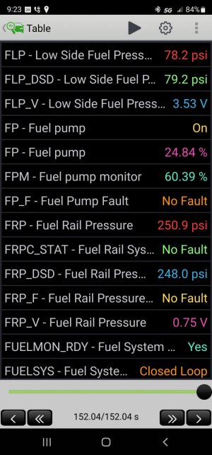

Here are PIDs pertaining to fuel

Also, the car is shuttering briefly when I go from steady gas pedal to letting off.
