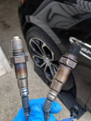

New o2 sensor.no change with sputtering look at that soot it's crazy bad compared to the do install.

Changed both front sensors? Both had same amt of soot? Did you clear the codes, and did they come back? P0234 is an overboost condition - possibly sticking wastegate or blowoff valve, maybe even a bad solenoid (very rare).
Yes both sensors were changed and all for nothing.did not change the sputtering...
