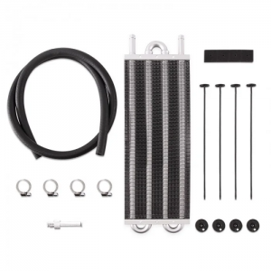

Assuming it's just splicing some some barbed T-fittings into the rubber area of the hoses, running the rubber hoses to a cooler, and mounting the cooler? Probably could just pick one up from O'Reilly's or something that would work well, similar to this:

The factory cooler mounts on the bottom of the crash bar, out of the way of the rest of the cooling pack. I don't think that one will fit there but you probably can strap it to the A/C condenser.

Yes, that was the plan is to mount it to the A/C condenser.

Yes essentially. I would not use those zip mounts though
