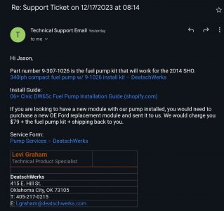

So it's just replacing the pump itself, not the whole sending unit assembly. What do they do for the module?
You should discuss with DW directly - I have only researched the Taurus. If he will reply to you, maybe PM directly Ecoboost_xsport for advice he has that saddle tank with the balancing, same system as yours, unless someone can elaborate here.
