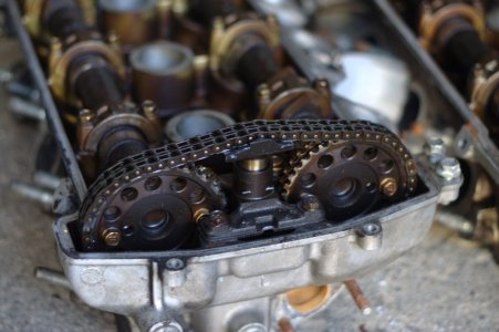

ran around town a bit and noticed when the engine was HOT (needle in temp gauge around the middle) there was a click or "ping" from the drivers side front of the engine... just around the edge next to the coil pack... not sure what it is, but I let the car sit and cool and started it up and no noise...

Umm, yeah, that's where the timing chains and tensioners are -- in the rear of the motor. See those there humps in the valve covers? :doh:

"""""If you are looking at the engine standing in front of the car, the sound is ***ONLY*** on the right hand side closest to you by the coilpack.....
Umm, yeah, that's where the timing chains and tensioners are -- in the rear of the motor. See those there humps in the valve covers? """""
Oh, gotcha, so what do I do about it and why does it only make noise when the engine is HOT?

because the tensioner part is a hydraulic cylinder with a spring inside it. when the oil gets hot it flows out the spray hole faster and the tensioner cylinder looses some of its pressure, then the chain flops around as the cam lobes transition from going "up the lobe" to "coming off the lobe" , that causes the slack in the chains to switch from top to bottom and makes some noise.
put a pressure gauge on the oil port to see what you have, then get back to us

Okay, haven't had the time or chance to take my cover off (is the seal reusable?) but on that SHO that was in the scrap yard, I got the intake (and everything on it 'cept the IAC Valve) and intake supports, speedo, and a few other odds and ends, took the valve cover off that one to see the condition and it looks like it was well maintained at least on the front of the engine (right side?) Valve shims looked new... but 130k on odo...
Good thing is they only want $25 a piece for the heads, and Autozone here wants $865 ea.
what I want to know is if it's slapping around when the oil is hot and all that will an oil change help fix that? (picked up some 10w30 (or 40, can't remember, been runnign too much) for both my Tauri...good thing they both take the same filter... (other is 96 Taurus G)
since the oil is hot and is thinner and flowing faster through the tensioner, will thicker oil and fresh stuff help? It's LOOOOOOOOOOOOOOOOOONG overdue for a change... previous owner filled it up before he gave it to me..and I added a bottle of stopleak stuff that slowly swells the seals (got a bit of bottom end leaking, but no MAJOR seals...
Going to run a can of SeaFoam through her... Any recommendations if the oil change doesn't fix the problem? what am I looking at here.?

Ran Seafoam through her, and changed oil afterwords and the clicking stopped. engine doesn't to a little high rev for a second after first starting either... I used 10W30 Castrol.
