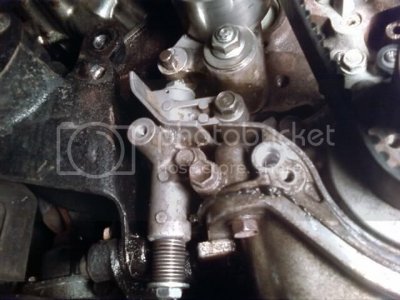

100% timing belt slap. Had that issue multiple times before replacing the tensioner's themselves three times due to failure. Then I started making adjustable tensioner's that have no fluid and will not fail. If you are interested in one just PM me. Here's a picture:

I made one with the help of some previous posts. So far so good, I have about 60 miles on it so far and the sound in my videos has gone away. Now I am trying to determine if the belt is too tight. I heard the "whine" the first day but haven't heard it since, maybe the belt stretched?
