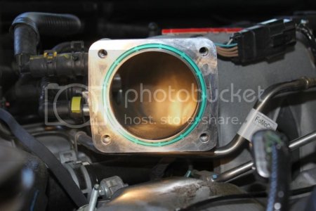

I had my Throttle Body intake hose off today as part of a Top Secret Project, and decided to stick my fingers thru the butterfly and feel how dirty the intake manifold might be. Got two sooty fingers....
IMG 2608

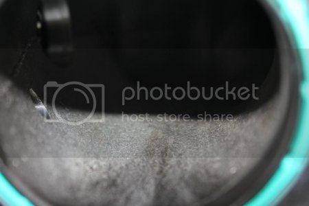

PANIC....:dribble::dribble: So I decided to remove the throttle body and scope out the intake (4 - 8mm bolts). I was pleasantly surprised to find that there was only a small area of slightly sooty area on the bottom of the intake, just behind the throttle body, and right where I brushed with my fingertips.
IMG 2636
Behind this area the entire intake was clean, both to the finger method as well as with a white towel.:thankyou:

The back of the throttle body was also clean.
IMG 2637
On my 2 Pontiac G8 GT's I have found a considerably greater amount of oil residue. In fact, I get over an oz of oil trapped in my catch(s) can every several thousand miles.
My conclusion is that Ford has effectively figured out how to control the residue from oil blow by that can coat intake manifolds, ports and valves that plague many direct injection engines. Their system of trapping the oil and allowing the overflow to harmlessly re-enter the system via the back valve cover seems to be working.:thankyou::woo-hoo:
However, I didn't remove the intake manifold and examine the intake ports and top of the valves.
Did notice the inside of the intake is quite rough. Would think a good polish/port job on both the intake and throttle body would have some positive benefits.
