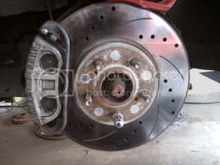

stock gen three brakesj w/ slotted and drilled rotors.

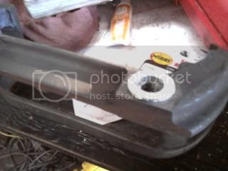

they appeared to bolt right up.. so i test fit them with the 11.6" rotors . all i needed was a couple washers to center them on the rotor.

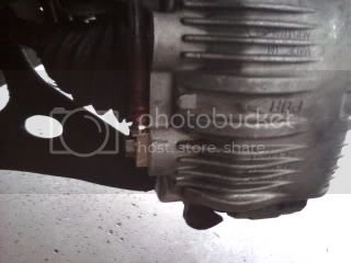

fitts perfect... pads come right to the edge of the rotor like it should. then i checked and the hoses bolted right up.. except i had to grind down the side of the hose on the drivers side to make it fit..

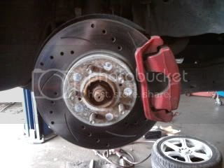

Final fitment
this was an easy near bolt on upgrade. brake pedal is very improved over stock and the calipers weigh probably less than half the factory ones.
