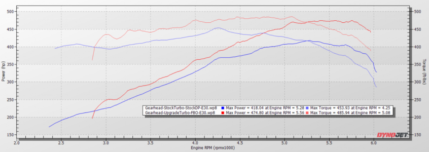

Nice numbers!!!
So here is an example of a top end you can get with bigger turbos...
The bigger pull was a conservative tune after getting the turbos installed... I specifically asked for 475hp to leave room on the table so we weren’t pushing too hard...
The lower tune was basically stock turbos, stock exhaust, E30...
For reference...

Not sure what mods you have? And mine was on a dyno jet. Mustang dynos can be calibrated to produce Dynojet numbers. I would say 426/446 is pretty good, do you have down pipes?
My first dyno was LMS HPFP, 3BAR, AIRAID CAI, and colder plugs... stock exhaust and stock down pipes and stock turbo...
The higher number was the works. And that was without the dual feed intake and a base upgraded turbo tune... it’s been kicked up a notch since...
The dual feed intake helps on maxed out stock turbos and aftermarket turbos.. so you might see something..

Ah, yes, the lower number on mine did that with the GH IC as well, but I didn’t have the down pipes.
So you are right on par then, seems like the mustang dyno you were on was calibrated to output like a Dynojet which is something they can do for power pulls... numbers are cool... but it’s the curves that show what’s going on.
I know Matt squeezes 450awhp out of his personal one with similar mods as you on his own dyno... so it’s doable... just gonna take some time/tweaking to get there... the stress/cost may not be worth it if you are looking to upgrade components further.
