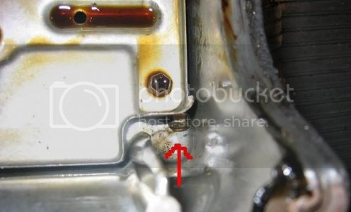

This happened to me recently. The bolt got lodged under the windage tray and wasn't going nowhere, but I wound up pulling the pan a) just to see for myself, b) for my own peace of mind, and of course c) to remove that dang bolt.
