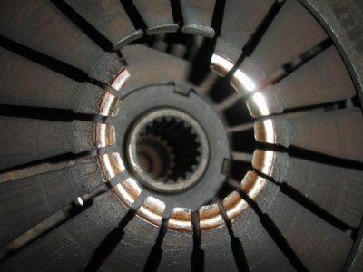

Your pressure plate fingers (and clutch) are worn, you might also be missing a few fingers on the pressure plate.
The PP probably looks like this:

Something you have not told us; was the old pressure plate damaged (like in the picture by SHO Continental) or was the release bearing missing a few balls? Were the rivets close to the mating surface on your old disc?

Attached are a few pictures of the old parts.

Thanks for the pictures, as that confirms your old clutch system was pooched.
