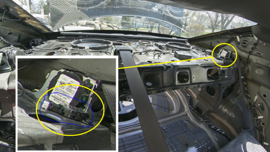

Searched this forum and other to no avail. Did find a guy on Youtube that claimed that the little speaker that goes under the rear tray can cause this faults when it goes bad.

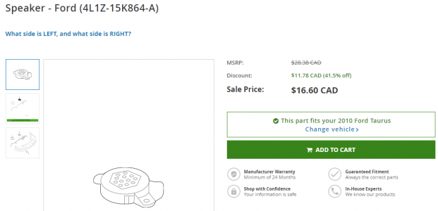

Ordered a new one from the dealer, PN varies by model/year.
Switched it an voila ! All fixed.
Older speaker was louder but heck, now every time I'm backing up I tell myself "this is how a 2022 SHO should sound like..."
To replace it, lower the driver's side rear backseat. Remove the plastic pin that secures the tray cover. Speaker is located right under it, secured by two plastic pins that can be easily pulled out.
