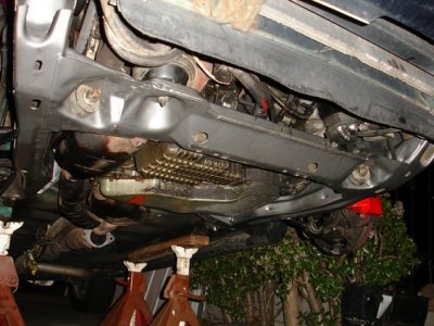

I had a similar situation a while back. Slightly overshot a driveway on some sandy street in hick town and half the subframe took on a curb. It was in the middle of a road trip/vacation so after everything checked out fine, no leaks, tire still good, etc I continued on my merry way.
Later on it seemed everything was pretty misaligned. In addition the trans was hitting the subframe in the front.
Ended up replacing the frame, which wasn't a bad idea anyways, slight rust on the original. Notice the front drivers side of the subframe..
Dsc13914
Dsc13931
