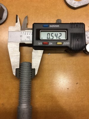

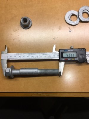

Here’s the 84130 dimensions.
They are sold individually
The 81280 are usually sold as a pair.
I used the 84130 on my 2010 SHO and they worked perfectly.

And here’s the difference between
84130 and 81280
841300b3b96aa1709455009908f2847944415
8128097fb7d11adde310a5a54a5e06fc4fd6d

Glock..... a point of clarification.
You compared a listed part of "81260" and the original part spec'd many years ago was/is "81280".
This variation is likely why you saw, or are seeing, the differences between the updated part number of 84130, and what others have used.
Thank you for the correction.
I just mixed up the numbers
The pic is the 81280
I’ll update my post
