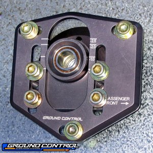

adidas_kn,
I think this would be ideal:
CCP3 fs
This is the universal 3 bolt camber plate from Ground control. As far as I can tell it acts as the strut mount, bearing, and upper spring perch. It also gives you additional travel, preventing bottoming out on lowered cars. It would almost turn the quasi-coilover G-C threaded perch into a full fledged coilover when used as a combo. This is what I would go with if the budget ever allows a full track suspension. Anybody ever use these camber plates on the SHO or otherwise?
