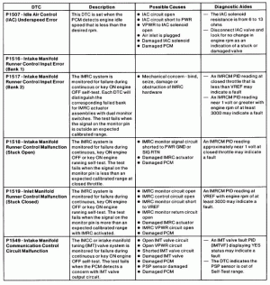

The car still drives normal, doesn't feel any diff. Could this have been just a fluke or something? I pray to god it is! :hail:

Pop the top off your IRMC box and you will see a frayed cable. It is still working and the butterflies are still operating (for now) but the frayed cable does not return 100% and the internal switch does not make contact so the PCM thinks it is stuck open. :frown:
