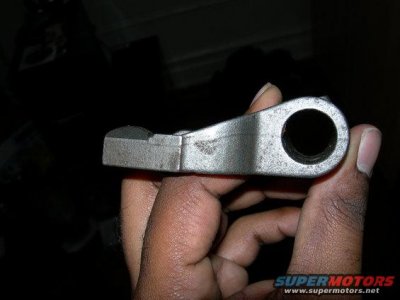

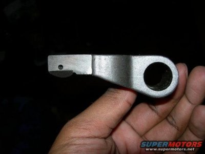

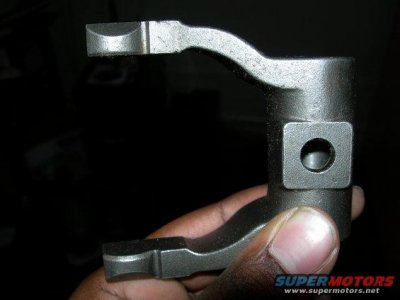

Is this the proper fork?

The whole enchilada:
Dscn1105
I still can't believe that I got all of that for under $60 shipped. :omg: :hdance:

Looks pretty damn close. I don't have one handy to compare, but I'd say you've probably got a better than 90% chance of it being OK.

FWIW, the SHO uses the same TOB Fork as the MTX 3, so that's the right part.

Howdy_Doody said:
There's a very similar fork used for the Tempo. I have one at work, I'll check on it tomorrow.
The SHO uses the same as the Tempo.

The TOB has a lot of play in it against the quill, and it's plastic there, so your fork would have to be severely worn on one side, maybe 1/4 or more difference, for the TOB to bind.
Finger wear, on the other hand, can be accellerated by a significantly unequal fork.

I looked at a sample I have at work (I work for a clutch company). The part number on your fork, 3014719, matches the fork I have on hand that I have researched as fitting a 1983-86 ****** and 84-85 Tempo (Ford part no. E3FZ-7N515A). I would look very carefully at your SHO's original fork and see if it is different.
I am trying to get a sample of the SHO fork (E6FZ-7N515A) to confirm all this, but it seems to have been discontinued. This fork also fits the 1986-94 Ford Tempo. Let me know how this one checks out
