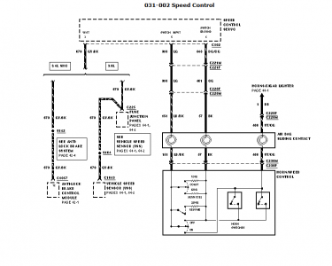

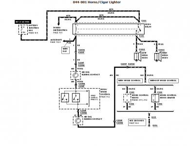

Not the most elegant solution, you can bypass the clockspring and install a push button on the dash. Connect across VT/OG and BK.
