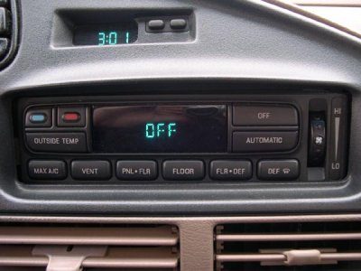

There's bit of a gap but otherwise better than cracked buttons.

Hey KC2SHO, your's looks a lot like mine. :thumb: But the one you have shows the PNL-FLR button which I would prefer (I understand the "big buttons" can be interchanged, so I'm looking for one). On the other hand, my unit doesn't leave any gaps, so I guess I lucked out there.
I picked up mine on eBay, it's a modded unit, the seller is an electronics pro. Been working great now for over a year, and I really like it. :)

Nice, I hadn't seen one that doesn't leave a gap yet. I'll have to keep an eye out for those and see if the buttons can be changed out. I've converted several units for various people to date. I have been thinking about trying to gather up donors to convert and sell. Thanks for the pic.

I had the whole unit from teh lincoln in and there was no gap, but once i switch faces there may be a gap. KC2SHO email me at [email protected] as i need your assistance.
