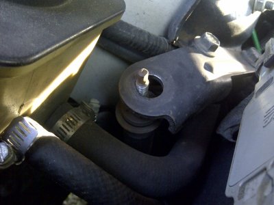

Well...step one is jacking and supporting the car I'd guess.
Before doing anything else, I'd be looking around underneath to see if there was anything obvious..like CV grease sprayed all over.
So yeah. Eventhough...
7,521
I think the vacuum canister that supplies vacuum to the secondary butterflies is bad, so when the engine is under load and the secondaries are supposed to be closed, they are chattering because there is not enough vacuum to hold them closed. no load, plenty of vacuum to hold them closed. at higher rpms they open and don't chatter. I would start by looking for vacuum issues at the secondaries.
