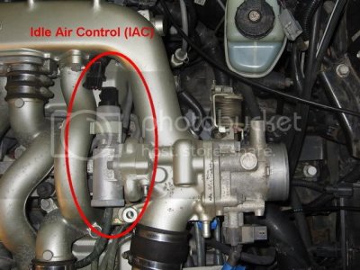

i dont know if you remember or not but about a week or so ago there was a post from someone about a humming sound coming at idol from the airbox we came to the conclusion that it was the IAC that needed cleaned.......well now i got time to do it and i was reading the faq about it and i dont really understand where the iac is actually located it could someone explain it to me a lil better? pictures of it would be great as i am a visual learner
thanks

Its behind the throttle body. It takes a 5mm hex key to remove the 2 scews. It is the small cylinder thing.

there you go buddy.

The lower mounting bolt is tough to reach. A long 1/4" drive socket extension with hex socket can reach under the runners to make it easier.
