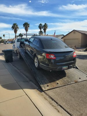

Was idling this morning and got a flashing check engine light. Sputtering bad with no power and heavy fuel smell. Pulled the engine cover and had fuel smoke come out the filler. Woohoo glad i got a 90 day warranty just gotta get it 40 miles to the dealer

Off to the dealer to have them fix it for free. Wooo just wont have it for a few days1268862356fe1929243c2677efd0c782
