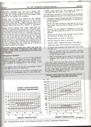

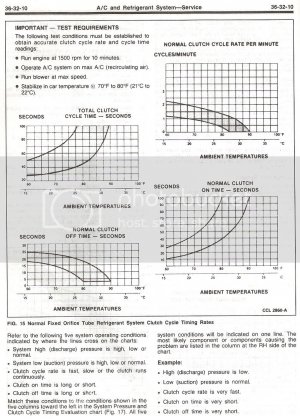

Yes, but the color varies by car. What might be green for most cars can be in the red zone for a Ford SUV. That's why I asked about finding the temperature/pressure chart for the '89 SHO.

Scan0004 zps916fa7d0
Scan0005 zps9e8a4bfd
But, on a system that is old and has a potential to leak, R12 will stay in the system. R134 will leak where R12 would not. People blame leaks on R134 when converting systems from R12. But, in reality, R134 will not leak out of a well maintained system.
To do it right the system needs to be flushed of the contaminants (stop leak) and the leaks sealed up correctly. New O-rings are cheap and don't damage your system. That stop leak stuff wreaks havoc on AC systems, especially fixed orifice tube systems and will reduce the efficiency of an already weak system.
