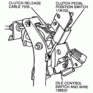

I had a forum member send me the procedure, but I don't have the file anymore. I do have it printed out though- but then again, my scanner is down... :frown:
This is the only image that I have of the file...

Loosen up that one main bolt that holds the pedal on the mounting plate deal, then pull the pedal out. You'll have to mess with the quadrant to get the cable through and allow the pedal to come out. Then the rest is simple, just replace it and slap it back it the same way you took it out. I have the instuctions somewhere, but can only type them up as my scanner part of the printer I have acts funny and doesn't work 99% of the time.

The kit will come with the blue adjuster arm, the white pawl, and the smaller spring for the pawl.
