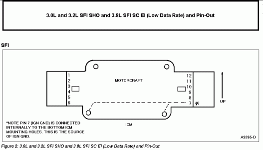

so im gonna change the icm, ive read somewhere to use heat sink grease where it attaches to the manifold, however in my all data account it says to use dialectric grease. are these not two different things? what did you guys use?

Just make sure there is grease around where the holes are at and you should be good. Its a 'pressure-type' connection, and that is where you would get your best ground from. I sanded mine down good, esp in the corners, and on the intake side. But here is also a thought.. I know what ford says, and I know people have DIS ground issues too. My thought on this is ... when I hook up switch gear at work, on a 4000Amp / 480 Volt service using aluminum cable, I have to use 'noalox' on it. Keeps out oxygen, eats thru alum-oxide, and is an anti seize lubricant to boot. If there is something better than this for that application, I'd surely love to know. I will fail an inspection if my wire isnt drenched in this stuff. Without it it corrodes, and after time the connection starts to go to crap, and all aluminum conductors as feeds, come loose after time, requiring maintenance re torquing. Big P.I.T.A.

Just run a ground wire from the rear lower DIS mount to the firewall where the other grounds attach on the pass side. Make sure those are all clean & tight! I run a permanent ground wire there. That way you do not have to rely on the ground path from different materials of the cast aluminium tanks,steel brkts & bolts! Esp if you have powercoating/painted parts! I keep my DIS module spaced away from the hot manifold as it produces less heat than the manifold does. There is no need for that dielectric grease. Its actually a silly place to mount it esp on an MTX!

Dielectric grease is an insulator, it has nothing to do with getting a good ground. What it does do, is to conduct heat, and to a lesser extent prevent corrosion. Its there to get a good transfer of heat from the ICM to the manifold, and to prevent oxidation between the two which would prevent heat transfer and result in the ICM possibly overheating.
