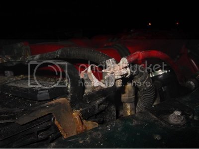

I have corroded cables on my 94 ATX and I want to change them. I took a look at them today and saw that it's not the simplest thing to do. I already got a positive cable and a negative splice kit from Autozone. My question is, How do I change the corroded cables? Do I need to remove the whole wiring harness?
Thanks for all your help,
Enos

When you buy the cables (from ford) they come as a complete harness with your ground and positives in it. You'll have to do some searching to find the cables as they are obsolete from ford.

Take a peice of string and measure the length of the cables, go to Auto Zone and get the right length Cables. Very easy to do, just a few bolts and you will have new wires.

If you have length you can cut off the ends and put new clamps on. I've done it on both my 87 GL and a 94 Topaz. Typically the wire is okay but the ends are crummy. Just get a good set of clamps.

I've done this to my 95 get the longest length 61"-65"? this gives you nice room for slack and placement. Cable ties are a must. For mine because of very big hands I had to remove the oil filter. I wear a size 15 ring. Also for ease unbolt the oil/ tranny cooler. The hardest bolt for me was the one that connects the negative cable to the engine. Never just replace the clamps this is inviting more trouble at a latter date.

I just did this on my 95 ATX. Got new cables at Autozone. I got a 48" positive wire and a 56" negative wire. They were about $5 each and the whole job took about 2 hours to do (mostly because I was real **** about it). Real easy job. :thumb:

Replacing the whole unit with the Ford piece makes it real easy. I bought the cable assembly a few years ago while it was still available from Ford. Pulled the old one out and put the new one in and all was happy. I'm sure you can replace it with bulk cable, but i'm not sure how you'd wire in the alternator wire.

so what do I do with the cables in the harness? Do I just need to cut open the loom and remove them?

Yes, that's just a protective loom. It's probably already split down its full length, so once you unwrap the tape on it it's very easy to remove the loom and separate the battery cables.

Yea, for me the hardest part was just removing the old cables and tearing out that nasty factory loom.
Mine were most definately shot. the terminals were so badly corroded that they broke apart into peices in my hands.
