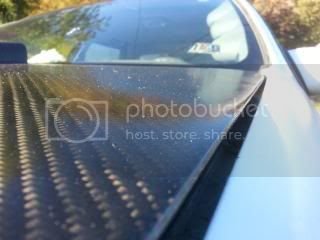

Got a carbon fiber gen 2 hood on my car and it dont seems to fit correctly.. where the hinges are it sots longer then the middle near the fender bulge upwards and it slopes bacl down at the lip.. seems wavey is what I mean but both sides are the same and the middle does sit above the fender some.. the stock latch dont even come close to latching.
I adjusted it for about a hour with no luck. It has a metal latch reinforcement plate but I do not plan to use it.. I got a set of pins coming in the mail.

It won't fit like factory no matter what you do. Remove the good latch and drill out the holes so you can raise the latch up so it will latch. Even using hood pins I would use the latch just in case you forget to put the pins in. Not that I have ever done that or anything lol.

Also I did try and raise the latch up seems like something just aint right. Comes close just not there.. a time or 2 it did almost grab

Super hard to get pics to show what I mean... the front lip os touching the headlight covers and the rear of the hood where the hinges are go below the fender lip yet the middle of the hood bulge above the fender lip

Your hood is warped. No amount of adjusting will get it to fit like the factory hood. It's a copy made from a mold of an aftermarket hood, and on top of that they have bad quality control.

So live with it huh? My question is am I the only one with a warped hood? I do have a fiberglass hood bit its blue and needs some tlc
