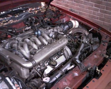

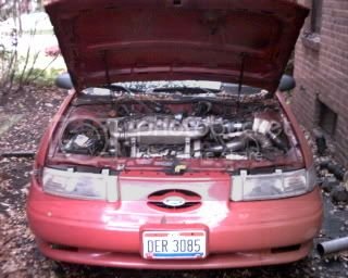

i too built and own a turbo sho. i only have a couple pictures tho.
CNXT0003 the ghetto fix you see there i since replaced with a metal section.
CNXT0001
CNXT0002
it was pretty simple to do... just took alot of thinking on how to make everything fit.

Is that car an atx?
yes. we'll see how it holds up. you have a 3" exhaust too huh. as you see in the pics (maybe??), due to the design I didn't have to neck down the exhaust pipe, post turbo. it's 3" all the way out, that makes for a 12% flow area increase pre/post turbo. now only if I could hear anything...at idle.
