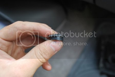

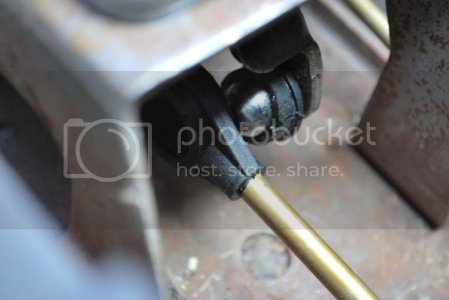

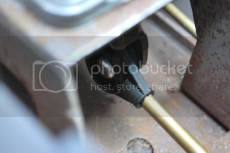

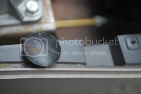

Long story short, I went to put the 89 in to reverse and got nothing... Had to open up the center console to get it in to gear and limp home.
DSC 0325
DSC 0328
The missing link:
DSC 0329
DSC 0330
DSC 0332
With that said, I do not want to upgrade to a Rod shifter, The cable shifter shifts fine. How do I go about finding this piece or fixing it?

There is a Mopar part number, I will need to look through my registry mags to find it. I am sure there is a memeber or two here that has the info handy though.

I've got a couple of the clips around. But they are pretty cheap, P/N 04340118. They come in a bag of 3 or so.

The mopar clip still wouldn't hold my shifter together. You may need to wrap the whole thing with a couple zip ties.

Sam, the bushing on my 91 disentegrated into many more pieces than yours, and the Mopar clip alone wouldn't secure it. I've got some zip-ties on it along with the clip for now, but I'm waiting for SHO Source's fix.

I use it to hold the rod (from the transmission, with the big hole) on the shifter. It was a pain to get on, and it didn't fit perfect, but it should do what you need it to do.

Thanks Kelvin, I threw it on and zip tied it. It does the trick. I drove the car around with no problems and did a heavy 2-3 shift just to be sure. It will work until SHOsource comes with a fix. Also, I took out the Center Console just to have more room to put it on.
