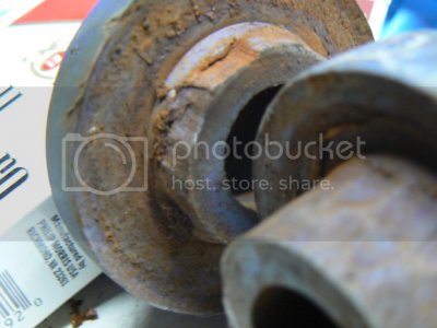

You can see the front bushings were getting chewed up by something.. not sure what this is from....

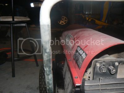

Gotta have heat! My best friend is red with a 165,000 BTU sticker on him..

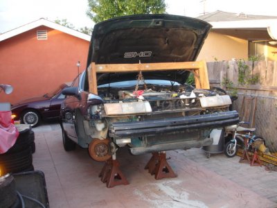

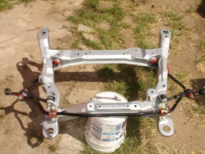

I usually try to work with ~16 inches of clearance. I replaced all those bushings on my '95 while I had the subframe out for a clutch job. I think I went a little overkill on the jack stands. But the frame came out pretty nice. (bumper was being replaced also)

lmfao i hope the rear wheels were blocked sho continental. i can see it now- *groan, smash, crunch* there goes the back of the sho and the side of the other car
Yes they were. But even if they weren't, my parking brakes actually work unlike the rest of the people on here. :sun: (referring to those multiple threads about peoples parked SHOs rolling into things.)
