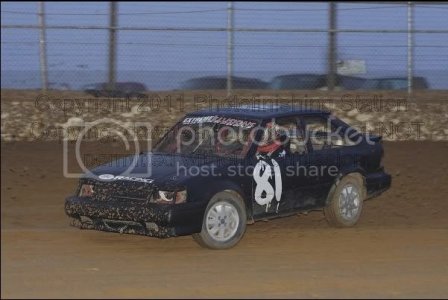

So i race at a local dirt track in basically unlimited fwd 4-6cyl class. Last season i began with a turbo'd ******, but after losing the water pump belt halfway through winning the feature i needed a backup until repairs could be made.
Racecort132
Enter my 1989 SHO i had as a backup car.
Sho2
It did great winnin 4 of the 9 races i ran it in. Two of those plagued by blown tires and two by a bad ign module ground. The car runs great but is a huge and a handful to drive on a dirt track. Thus leading to this years car, my original racecar, a 1987 ****** gt. Only this time it got a real motor.

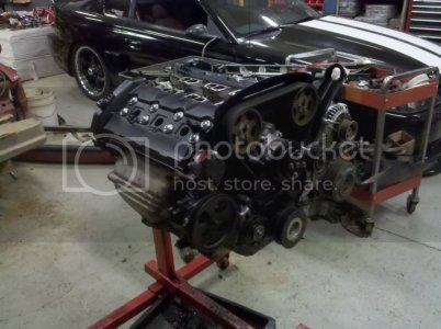

Shoscortengine2 1

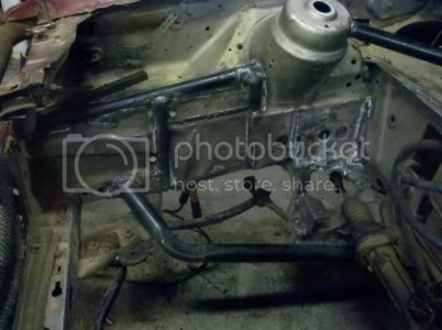

Shoscortframe

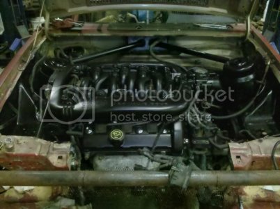

Shoscort10

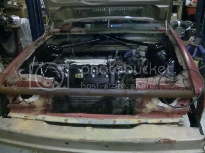

Shoscort15

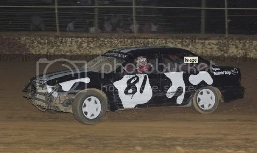

5 long weeks after begining this adventure the car is mostly complete and i was able to make the first race with it this past friday. It's a rocket and is a load of fun to drive out there. I won my heat race but unfortunantly blew the right rear on the 3rd lap when someone shot into the side of my car. Heres hoping to a successful race this week.

Super cool, great work. What trans did you use for this monster? What were the hardest parts of the swap for you?

Dont telll anyone, but the SHO MTX is basically the same case as used in the early escorts. The ****** mounts fit directly and it bolts right in. Just had to lengthen the ****** shift linkage 1.5 in. Differential is welded for full time posi. SHO axles shortened to fit, even the splines on the SHO outers fit in the ****** hubs. I think the hardest part was making sure i clearenced the fram rail enough on the crank pully side, that and getting the lower radiator hose on after the engine was in, as i had kinda forgotten about it when i fabbbed the front engine mount.

Will your ****** trans bolt up to that engine? I bet it does. And it might have a taller ratio in second.

As far as the ****** trans goes, it wont bolt up. The motor side of the transmission case has a different bolt pattern. The ****** internals are smaller and weaker also. Originally i had planned to use the ****** diff in the sho trans so i wouldnt have to modify axles but soon found everything inside the sho MTX to be beefed up a bit in comparison. If you bring this up due to the pleasant sound of mid straight away rev limiter, i burnt a chip this week to up the limiter a bit. We'll see how close to the corner that gets me.

Was going to do a black and red paint scheme on the engine but after doing the valve covers I really liked it and decided to just go the stealthy route and keep it all black.
