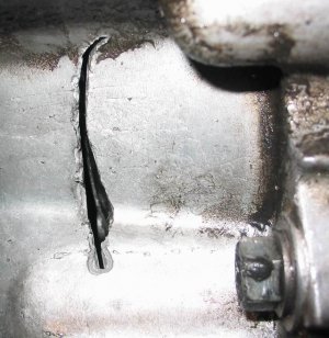

Mark, just for reference, here's what it looked like when it happened to me...
Strap damage
...although I'm curious to see whether yours is a strap or something else.
