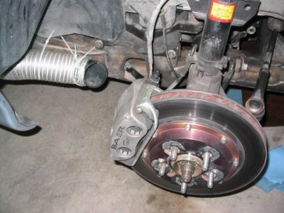

Yes, you can get two-piece rotors for the Baer 12.5" kit from Todd. Here's the first set ever made, well worn, been through a few sets of rotor rings already:

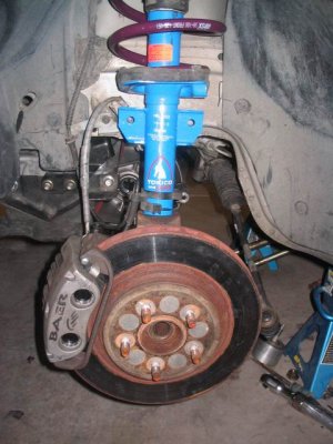

Ok, if we are posting pictures, here goes. :)
The rust on the rotor is the result of having the car sit for 3.5 months while I completed the engine swap. Note the thin .81" rotor and extra thick hat to use with the slicers. (This is the old style TCE hat. From what I understand, the new kits that Todd ships come with the beveled edges that Jedhead and SHOaz have.) FWIW, these are the Wilwood Billet Superlite calipers; I will be replacing them with the stiffer Forged Superlites once I upgrade to 1.1" thick rotors. At this point I'll probably stick with the 12.2" diameter to save on rotational weight, cost of replacement parts and the possibility of using aftermarket 16" wheels in the future. As a daily driver, my only requirements at this time are that I have a summer rim with summer tires and a winter rim with somewhat hi-po all seasons mounted on them.
Ian
