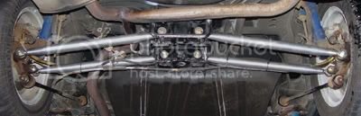

I like ours.
Rearcontrolarms
$400. Takes about 2hrs to install. Aluminum bars and teflon lines heim joints and in stock.
Our bars are set up with LH and RH threads in the joints. To adjust the toe and camber settings you simply loosen the jam nuts and twist the bars. It makes getting a good alignment a lot easier. Also, with the high tensil strenght heim joints, there is not deflection like those with rubber bushings. This means that with our bars, you can run less negative camber and still get the handling in the turns.
We even have provisions to mount the proportioning valve.
