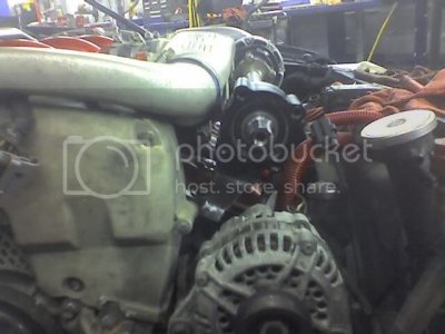

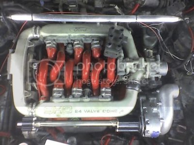

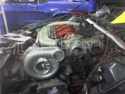

If you're running the streets of Maryland in the near future and run up on a green '92 that sounds like it's got a bad alternator bearing, you might want to think twice about taking it on.
Photo 031707 012
Photo 031707 004
Photo 032507 010
Photo 031707 009
This one is our latest blower car. It's got a bunch of our stuff underneath, under the hood and out back.
Should make *the* noise quite nicely.
Vortech Shaft Drive V2-SC
Custom ASP Pulleys
48lb Accell Injectors
BA2400 MAF
SCT Tuning
FPS Built tranny with Dual Diaphragm clutch
& Quaiffe differential
FPS/PP True Hi-Flo Y-pipe with cats
Walker/Dynomax exhaust system
FPS 12" Brake Kit
FPS Aluminum Subframe Bushings
FPS Subframe Connectors
FPS Aluminum Control Arms

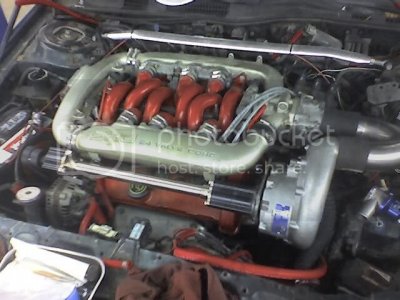

Looks fantastic, Doug!
I really like the look of those shaft driven kits. Have you ever experimented with any time of after/intercooler..?
ty91sho
EVRYDAYHUSTLIN'
Oct 23, 2006
938
44
st.cloud MN
can you get the oil cap off to change the oil? ahah i just seen that and was like that looks alittle tight.:nut: anyway i like it! lookin good!:thumb:
SHO Dude
Sponsoring Vendor
Sponsoring Vendor
Aug 31, 2004
1,121
111
Southeast
We've been looking into the FMIC and have figured out a way to do it. Just haven't had the time or the need as yet.
At 9psi of boost, these cars are consistently putting down 325 on the tires and yielding 25-26mpg on the highway.
A FMIC would allow for more fuel and more timing, so maybe on my car. We'll see.
SHO Dude
Sponsoring Vendor
Sponsoring Vendor
Aug 31, 2004
1,121
111
Southeast
Comes right out. Slips under the shaft. You need a funnel to fill it, but the cap does come out.

How about a air/liquid cooler? It looks like there would be room for a single core unit on the driverside of the engine bay there. That would keep the charge piping short.
Phoenix
SHOHOLIC
Mar 2, 2007
3,767
1,646
QC , Canada
If you look at the first pic , lets say you wanna add oil into it.......
Heheh just messing around , looks good :thumb:
Off Road SHO
Moderator
Jan 16, 2002
5,684
1,292
X2

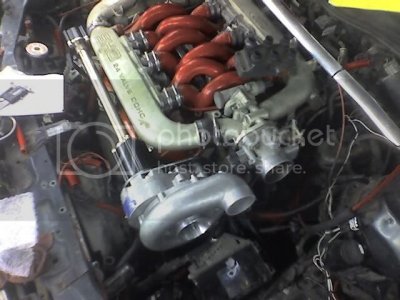

Starting to take shape...
Photo 040707 006
Oiling system, discharge plumbing and bypass, then a little tuning and off we go.
SHO Dude
Sponsoring Vendor
Sponsoring Vendor
Aug 31, 2004
1,121
111
Southeast
Gotta love the Load with Failed MAF table in the stock programming.
Th FirstStartwithBoost
Few more things to wrap up. Inlet and discharge plumbing, coil bracket, MAF and tuning. Then it'll be ready to make the noise.
