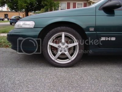

Hi I have a 94 mtx with 96 brakes and now I finally got 17 inch wheels what is required to do 13 inch brakes like the mustang ones? Thanks Andrew

Any specific year? should I buy loaded calipers?
not really. some years had 38mm pistons, and some had 40mm pistons. Loaded calipers will have brackets and pads. Any 13" cobra rotors will work but you need to have them either re-drilled for the correct bolt pattern, or just elongate the holes.
Also, be aware, not all 17" wheels clear 13" brakes.
