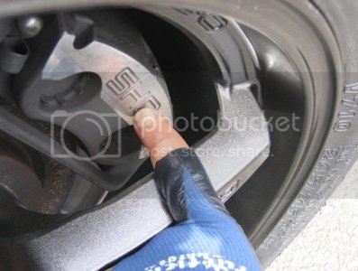

Oh, and here's the other added bonus with these rims. There's plenty of space in there, in case you ever decide to go with really massive front brakes (i.e. Brembo Cobra R 4-piston calipers).
Clearance
Look how much extra room there is even with the PBR calipers in place! :hyper:
Wow thats seriously a selling point for me. I had pbr's on bandito and it wasnt good enough for me. This is very interesting. Im assuming when you bought these wheels you just did the search on a gen3 sho right?

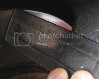

I took a measurement of the clearance between the rotor and the spoke. A whopping 66 mm, and this is on the 17" rim. You only need 50 mm clearance to fit the 4-piston Brembo calipers, according to the link. That's more than enough room!!
