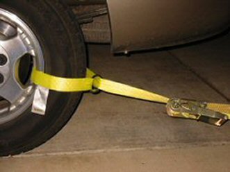

are you running a rear strut tower brace and or subframe connectors?
you did remove the factory tow tie downs on the bottom rear of the car right? I would imagine so being a gutted car but i'm just looking out for you :)
shomesomesho
G-force addict
Mar 1, 2005
1,206
43
more rubber, more HP.....
Yep, has RSTB and SFC's.
No, hadn't thought about the tow tie downs. Great idea!
But wait, what am I gonna use to secure the car when I trailer it??
