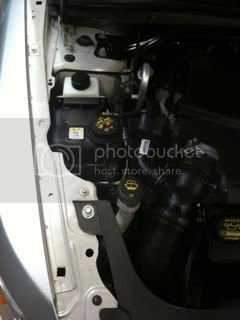

So I'm wondering if anyone notices anything different in this pic? (Except for a dirty engine compartment....I know Mike is turning over in his squad car right now! I'll try to take care of that tonight)

How about now??

Sorry for the small pics....didn't even know how to post pics until today. There is a new reservoir....it's part of my new windshield washer reservoir. The old one is now home to Methanol!
Results are soon to follow...I do know on a conservative tune my hp is up 50 and the torque up 60 ftlbs from my previous best from 5000 to 6200 rpm
