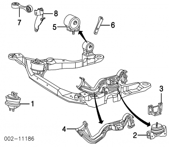

If not anchor then who transmission mount taurus car club of 1999 ford taurus transmission
Front and rear ones are easy to find in Rockauto site but the trans mount have been forgotten in taurus page. Ford part number is something like F6DZ-6F062-?? but Google gave nothing. By some hazardous ways, I was able to found those numbers for the part at Rockauto. Comparing them on other sites after, It's appeared that ones at around 10$ can be solid... not hydrolic (I want an hydrolic). One way to know is there is a "S" after the part number (for "solid") but not all manucfacturers do this, some put an "H" after too.
Trans mount parts :
ANCHOR 2717 (hydrolic, according to an old post here)
https://shoforum.com/index.php?threads/motor-mounts.82871/#post-827249
WESTAR EM2717 (solid ?)
ULTRA-POWER 2717 (solid ?, back order)
see also (elsewhere)
MOTORKING MK2717
WALMART # 557606587 (solid !?)
After a while, I found those additionnals. The 2 first are hydrolics.
RODATECH 1224H
RODATECH 4325H
ANCHOR 2974 (Rockauto affirming it's for 2000-2007 Taurus... same shape however, improved ?)
DURALAST 2974
Image for reference (part concerned here is #2):
00211184
