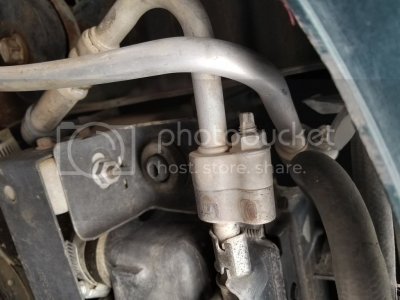

Not sure if you are still working this or gave up.
To be sure, there are two different connections at the condensor depending on models, one is a screw clamp style like the picture below:
20170514 150808 zpsplobwvjj

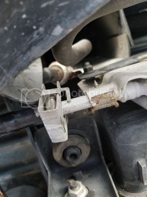

The other is the spring lock:
20170514 150834 zpswlm5jydc
Which one is yours?

Interesting info Sho Fan! I only have '96 models so far, and never really paid attention to that part when going to the pick-a-part yards. ;) Those pic's are from my SLO (top) and SHO #1 (Bottom) which are both '96 models.
I suppose from what you are saying one could just take the parts off a GEN3 SLO to retrofit them on the SHO since they are the same except for the connections.
