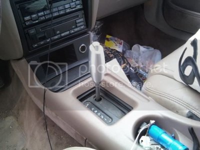

It's not that bad. The hardest part is removing the C-clip on the shifter. I used a set of picks and it worked well. Once that's out, you remove the cupholder insert and undo the one torx screw at the bottom. Then, you just kinda yank the top of the center console out. It's held in with friction clips. I would recommend putting the shifter in "1" to allow more room. Then, you undo the connector that goes to the O/D button (yank on the shifter a little to locate the wire, it's small!), undo the clips that hold the wire onto the shifter assembly, and gently lift up, making sure the wires don't catch onto anything. Installation is largely the reverse of removal.

Never had goo come out either. Car is a 95, and is regularly in the sun. I do, however, like that 2nd shifter ****.

Hey, that looks familiar!
3039 81458845939 668645939 2227206
Edit: we bought a big pack of rubber grommets and found one that filled up the hole where the shifter goes into the console, and another one to locate the bottom of the shifter so it doesn't wiggle around at the bottom.
