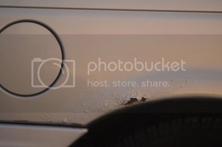

Right rear quarter panel rust.

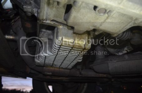

It's leaking, something. Any ideas? I didn't get a closer look, but I saw oil on my garage floor. Not much, just a drop, but enough to make me want to get it fixed.

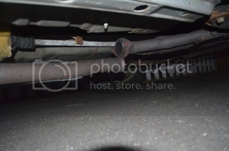

The exhaust problem. It's stupid loud right now, so I need to get this fixed. Ideas?

Oil leak from the rear of the motor, possibly the rear mail seal.
That rust is in a not great place.
The exhaust...it's hard to tell. Either get a new midpipe put in with a new ******, or a replacement is available. It doesn't look like any of the exhaust piping itself is rusted away.

Yeah I was hoping it wasn't the rear main seal. I can imagine that's probably a PITA to fix.
The rust I can deal with. Once I get the exhaust and this oil leak fixed, I plan to get it painted and I'll have the rust fixed.
As for the exhaust, I may just get it welded back for now so I can at least get it inspected and on the road unless I can find a stock replacement on here or online.
They make a repair ****** to fix that. The piece on the rear pipe has rotted away and is missing, and the new one is 2 pieces to go around the pipe. You'll probably need new bolts and springs as well.

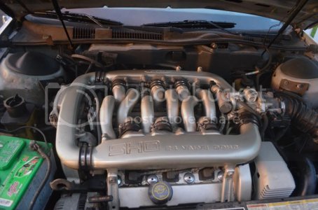

Looks like the spark plug seals may have failed in the past, so at least a valve cover job's probably been done. Service records?
That's what I thought. I'm guessing this is something a muffler shop can probably weld in place? If so, I can at least get that done tomorrow.
No service records. It had 52,000 miles on it in 1998, and it had the 103k on it now. It recently had an oil change at Koons Ford in Maryland. I found it rotting away at a crappy car lot in Rockville. For $1,800, it was hard to pass up with that kinda mileage.

With all this being said, what should I do about this rear main seal business? It's not pouring out oil, but I'm not sure how long it can wait either. Thanks for all the help, glad to be in the club :wave:

Based on how much it is leaking, I'd leave it alone, unless you feel like doing a clutch. There is also a gasket for the cover on the rear of the engine that the rear main is in, and the oil pan seal. You can also check the low oil level sensor at the firewall side of the oil pan to see if it is leaking, if so, that can be resealed without having to do a ton of work.
Like Timbo said, there is a replacement ****** available. That connection is bolted together. If you weld it, you'll have to cut the exhaust apart to do something like a clutch.
New midpipe is WALKER Part # 45606 goes from y pipe, to the 90 deg. bend in front of the gas tank
The ****** repair kit is WALKER Part # 36128

Got the exhaust problem fixed and finally got to open her up a little more without it sounding like a V6 rice rocket.

The rear main seal is my next obstacle. I'm going to solicit some help to get this done probably via craigslist. I can inspect the clutch while I'm at it and I can replace it if need be at that time.

Good looking project ya got going on there, good luck with it. Glad I opened this thread because I've been dealing with the same exhaust issue and had mine welded :( Didn't know those Walker parts were even available to fix it :)
lol, that's exactly what I had done. Cut out the rotted piece, put in a new pipe and welded it together. Sounds a lot better now than it did prior to.

I'm curious about that rust. It looks like it started under the paint. Is the inside of the wheel well solid? Mine looks perfect but there are a couple tiny 1-2mm in daimater placed where the paint is bubbled like it's lifting, similar to yours.
The wheel well still feels solid. That's the only reason I'd rather just fix the furst, buff and detail the SHO instead of getting it pained. I just don't want to spend a few grand painting.

I would think you could get it fixed and blended without having to paint the whole car...
